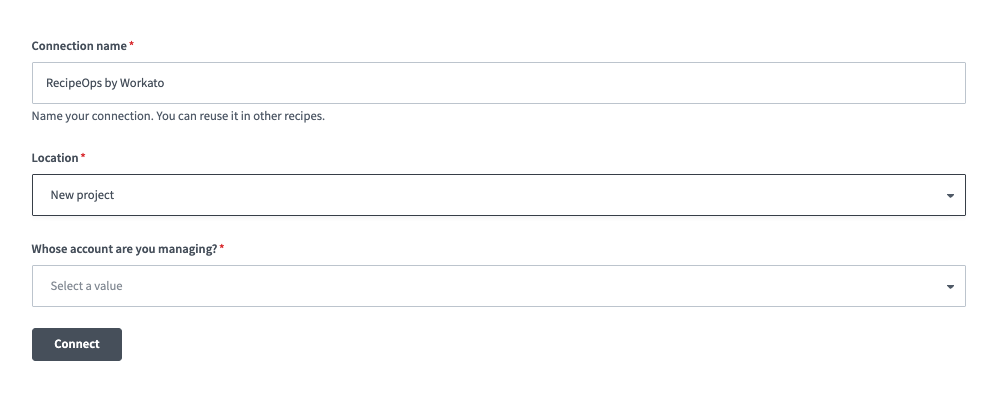

Set up your RecipeOps by Workato connection
Complete the following steps to set up your RecipeOps connection:
Click Create > Connection.
Search for and select RecipeOps on the New connection page.
RecipeOps connection setupRecipeOps connection setup
Use the Whose account are you managing? drop-down menu to select My account.
CONNECTION PRIVILEGES
RecipeOps connections configured to monitor My account have admin privileges and access to all RecipeOps actions and triggers in your workspace, regardless of the role of the user creating the connection.

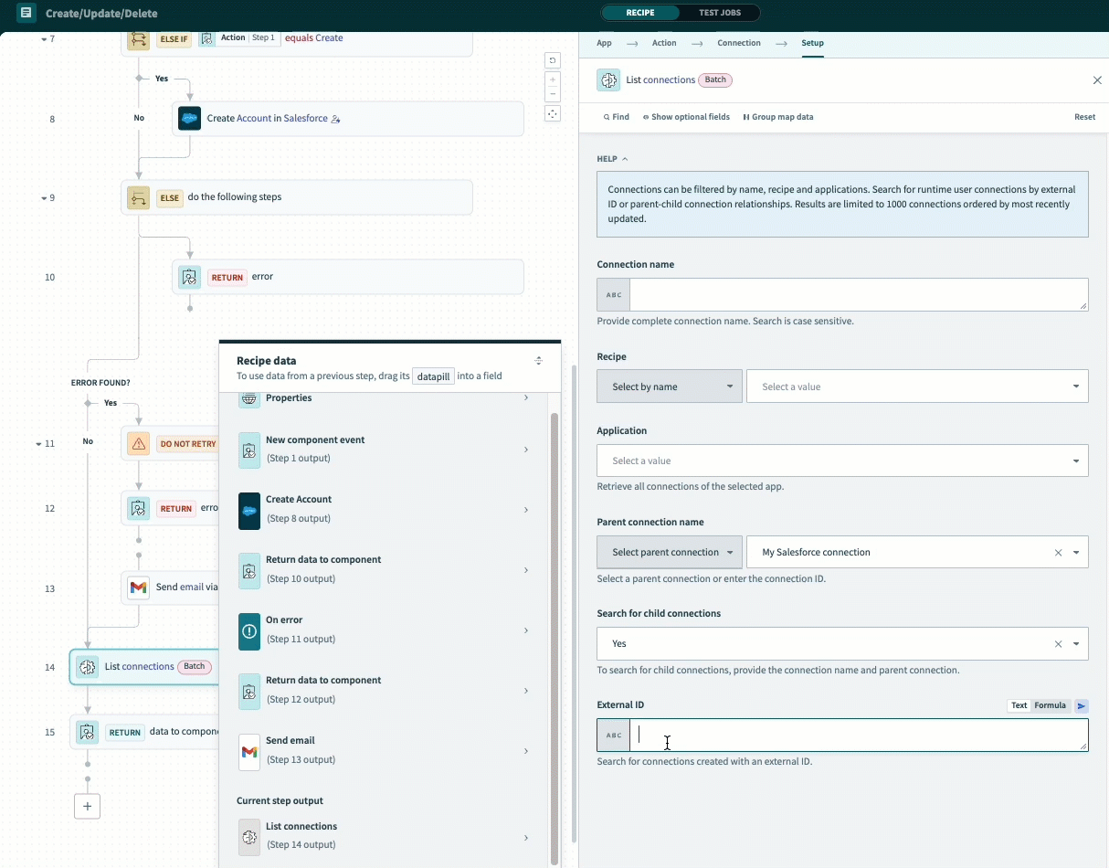

Configure the List connections (batch) action
Complete the following steps to configure the List connections (batch) action:
Use the Parent connection name drop-down menu to select the parent connection name. Alternatively, you can supply the parent connection ID.
Use the Search for child connections drop-down menu to select Yes.
Map the New component event User ID Step 1 datapill to the External ID field.
List connections action setupMap the New component event User ID Step 1 datapill to the External ID field

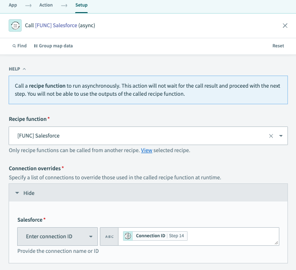

Set up your Call a recipe function action
Complete the following steps to set up your Call a recipe function action:
Use the Recipe function drop-down to select the recipe function you plan to call.
Go to Connection overrides and map in the List connections Connection ID Step 14 datapill.
Map in the List connections datapillMap in the List connections Connection ID Step 14 datapill

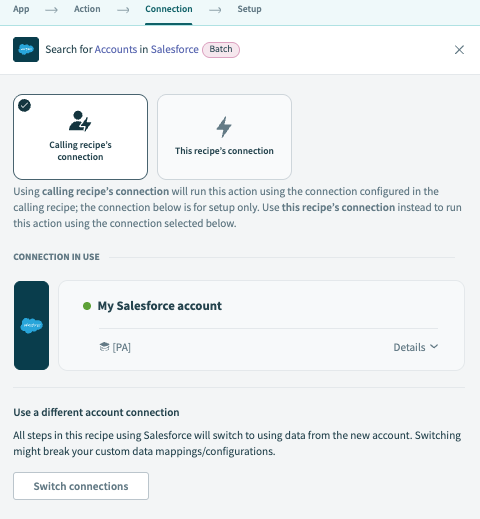

Select the Action in an app that you plan to use with verified user access.
14
Go to the Connection tab and ensure the app is configured to use the Calling recipe's connection.
Ensure the app connection uses the Calling recipe's connectionEnsure the app connection uses the Calling recipe's connection
