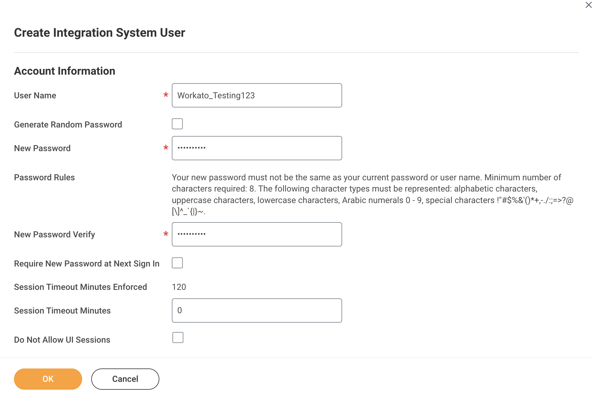

# Create an Integration System User
Complete the following steps to create an ISU in Workday:
Type Create Integration System User into Workday's search bar and select the task from the results.
Search for Create Integration System User task in Workday Search for Create Integration System User task in Workday
Enter a username and set a password in the Create Integration System User task.
Create integration system user Create Integration System User
Set Session Timeout Minutes to 0 to prevent the ISU from timing out.
Ensure that the Do Not Allow UI Sessions checkbox isn't selected.
Go to the Maintain Password Rules task.
Exempt the integration system user from password expiration by adding them to the System Users exempt from password expiration field.
Exempt ISU user from password expiration Exempt ISU from password expiration

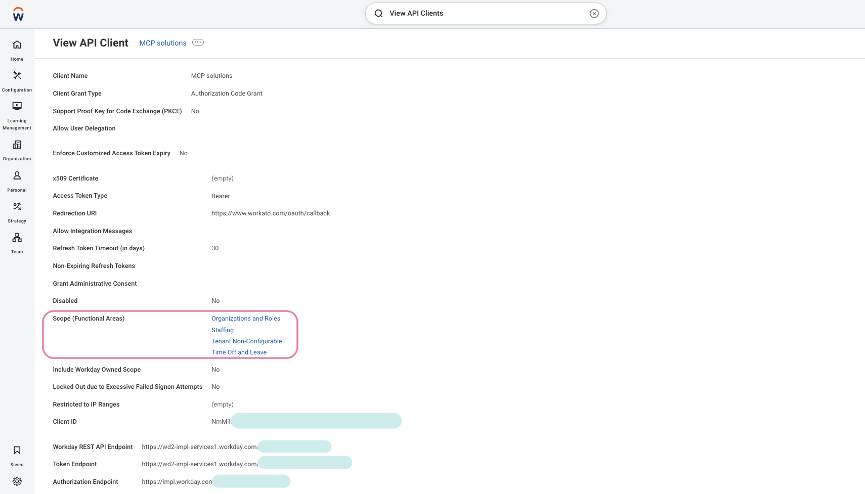

# Find your token endpoint URL
Complete the following steps to find your token endpoint URL in Workday:
Enter View API Clients into the search field in Workday.
Access the View API Clients report from the search results.
Save the URLs listed in the Token Endpoint and Authorization Endpoint fields. These URLs are required for the OAuth 2.0 connection.
Save the token endpoint and authorization endpoint URLs Save the token endpoint and authorization endpoint URLs

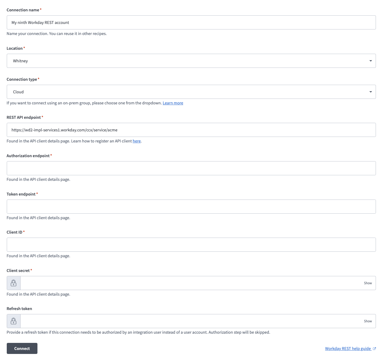

# OAuth 2.0 authentication
Complete the following steps to configure your Workday connection in Workato using OAuth 2.0 authentication:
View OAuth 2.0 authentication steps
Enter a unique Connection name to identify your Workday account in Workato.
Set up your connectionSet up your connection
Use the Location drop-down to select the project or folder to store this connection.
Use the Connection type drop-down menu to select Cloud.
Enter your REST API endpoint in the REST API endpoint field. You can find this endpoint in your API client details page in Workday. For example: https://wd2-impl-services1.workday.com/xxx/api/v1/example
Enter your authorization endpoint in the Authorization endpoint field. You can find this value in your Workday API client details. For example: https://impl.workday.com/example/authorize
Enter your token endpoint in the Token endpoint field. You can find this endpoint in your API client details page in Workday. For example: https://wd2-impl-services1.workday.com/xxx/oauth2/example/token
Enter your client ID in the Client ID field.
Enter your client secret in the Client Secret field.
Enter your refresh token in the Refresh token field.
DON'T PROVIDE A REFRESH TOKEN FOR WORKDAY END USER MCP SERVER
Don't provide a refresh token if you're connecting to the Workday End User MCP server. Leave this field blank.
