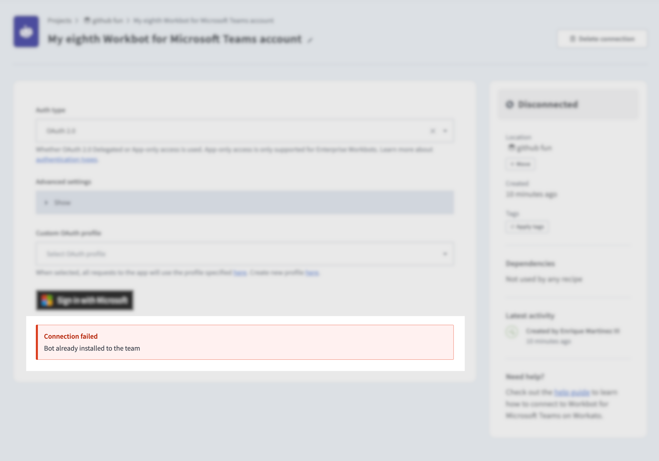

"Bot already installed to the team" error
The Bot already installed to the team error means another standard Workbot connection is already active in your Microsoft Teams organization. Only one standard Workbot connection per Microsoft Teams organization is supported.
Duplicate Workbot connection error
Perform one of the following actions to resolve this:
- Find and disconnect the existing standard Workbot connection, then attempt to connect again.
- Use Enterprise Workbot to run multiple Workbots in the same Microsoft Teams organization.
