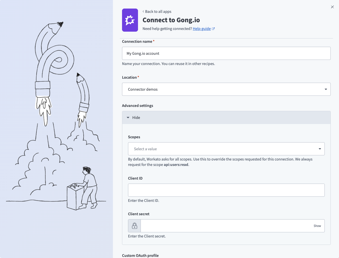

Connect to Gong with OAuth 2.0 ​
Complete the following steps to connect to Gong in Workato:
Search for Gong.io and select it as your app.
Connect to GongConnect to Gong
Expand the Advanced settings section to configure Scopes for your connection. Workato requests all available scopes by default. You can select granular scopes from the multi-select list to limit access.
Enter the Client ID and Client secret. Refer to Gong setup for more information.
Sign in to Gong using your credentials when prompted.
Click Allow to provision access to Workato.
